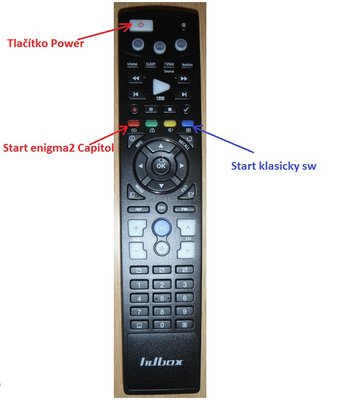

V tomto okamihu uz mame nahranu vo flash verziu enigma2 HDready ,alebo multiverziu, podla toho , ktory *tar.gz subor sme pouzili .
Prijimac ale startuje vzdy ! do enigma2 HDready a pre nastavenie treba pouzit klasickeho sprievodcu instalaciou enigma2 .
Prednastaveny je ICE reader - bez moznosti zdielania a podobnych zalezitosti. Menu - plugins (moduly,alebo addons) a tam zelene tlacitko umoznuju ale stiahnut a pouzit aj ine aplikacie pre obsluhu citacky .
V pripade verzie Multi sa prechod do ineho rozhrania robi cez Menu - Vypnut a tam najdete volby - restart Neutrino,alebo XBMC atd...
Pre prostredie XBMC je nutne pouzit rozlisenie 720p - nie vyssie! z dovodu vysokych hw narokov rozhrania .

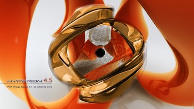

08 dec 2014 08:55 - 03 feb 2015 18:01 #12497
Odpoveď od TitusXX na tému Re: HD-BOX FS - 9105 HD plus
Enigma2 Hyperion v4.5
USB verzia
Added by PKT:
[ALL] fix cam start at startup tuner
[ALL] fix scrollbar
[SH4] add new WiFi Driver Manager
- restart GUI is required to detect WLAN stick on main network setup
- all drivers directly from GIT should be supported
- 'try driver' can be selected only when all driver is inactive
- eth0 is automatically up when 'disable driver' is selected
[SH4] samba update and 2GB fix
[sh4] fix samba setup if IPV6 in kernel is enabled
[sh4] update rtmpdump and librtmp for IPTV Player
[sh4] eplayer image in NOR 32MB optimalization
[SH4] SyncTime - fix update script
[mips] fix tuxtxt encoding
[sh4] Removed CrossEPG from image - now only on feed
[sh4] add Remote Manager
[sh4] add mount by LABEL in HDD Manager
[ALL] fix detecting network interface and code optimization
[SH4] fix esi cooler standby
[MIPS] Shoutcast update
[all] add Memory Cleaner
[all] add NTFS to HDD Manager and ntfs-3g support
[ALL] add IPTV Player optimalisation
[SH4] disable clear cache for UFS910
[SH4] add UFS913

Added by PKT:
[ALL] fix scrollbar
[SH4] add UFS913
[ALL] fix manual backup restore
[ALL] many other bugfixes not included in this changelog
docs.1d5920f4b44b27a802bd77c4f0536f5a-gdprlock/file/d/0B4Qbc9MNrtNpc09jdTZseUxFZU0/edit
login: root,
pass: pkteam
Príloha pkt4_5.jpg nebola nájdená

Výber verzie sw pri štarte :
Zapnite prijimač , na displayi sa zobrazi informacia o verzii hw , teda namiesto Lx:XX tam uvidite nápis bud 7119 ,alebo 7819 . Počas tohto nápisu máte možnost vybrat typ sw , do ktorého chcete naštartovať !
Červené tlačitko na dialkovom - kratke stlačenie , zavedie sw enigma2 -Capitol vo flash
Modré tlačitko na dialkovom - kratke stlačenie - zavedie originálny fw vo flash
Na dialkovom sa jedná o tlačitka určené pre txt - teda farebné tlačitka v rade . Nie tlačitko power ,alebo record !!!
Príloha dialkove.jpg nebola nájdená
Štart originálneho sw :
Originálny sw vždy štartuje do standby modu ! Teda naštartuje a vypne sa do standby ! Je potrebné ešte krátkym stlačenim tlačitka power na dialkovom spustit prijimač. Kto chce štartu do standby zabránit môže počas zobrazenia loga originálneho fw na TV , stlačit krátko tlačitko Power na dialkovom - potom naštartuje do plnej prevadzky .
Prechod z jednej verzie do druhej :
Z originálnej verzie do Capitol enigma2 - dlhé podržanie tlačitka Power na DO a potom počas štartu vybrat (červene tlačitko) a štartuje Capitol enigma2 .
Z Capitol enigma2 do originalneho fw - Menu - vypnút- Reštart ,alebo hlboky spánok a potom pri štarte vybrat modrým tlačitkom štart originálneho sw.
Prijimač si pamäta naposledy použivany sw, volbu typu sw nieje potrebné vždy po štarte vykonat ! Volba typu sw sa robi len pri uvažovanej zmene !

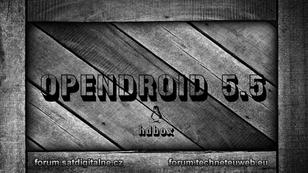

enigma2
Opendroid 5.5
drive.1d5920f4b44b27a802bd77c4f0536f5a-gdprlock/file/d/0B4Qbc9MNrtNpVjh...R2c/view?usp=sharing
Opendroid 5.5
Príloha bootlogo_hdbox.jpg nebola nájdená
