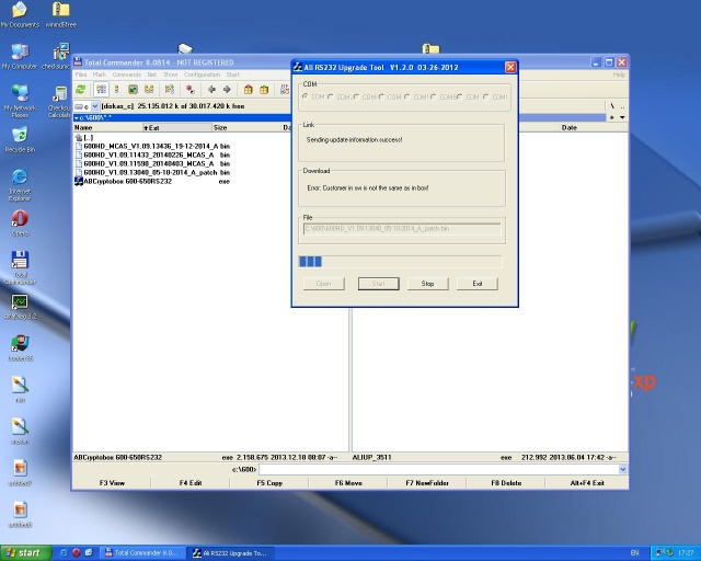

Hello.
Maybe what you cryptobox Suggestions 600HD original 25Q64fvsig Winbond flash programmer from the dump? I tried to update the firmware and tuner 600HD_V1.09.13436_19-12-2014_A it to crash. He now will not turn on, stay with the panel saying "BOOT".
Through the RS232 port also not flashing.
Thanks.

17 jan 2015 22:00 - 17 jan 2015 22:02 #13446 od donceris
Odpoveď od donceris na tému Diskusia
martin dano napísal: Hello.
Give an older software is not new via RS 232
from this website : http : //www.digitalne.ellano.sk/forum/ab-cryptobox/4040-upgrade-rs23
software from www.digitalne.ellano.sk/forum/ab-cryptob...600hd-firmware#12712
600HD_V1.09.13040_05-10-2014_A_patch.zip
Hello
I tried to do this, the problem is that the computer can not understand the receiver and there is no update available.
Even waited 1 hour and nothing happens.
Posledný krát upravené:17 jan 2015 22:02 donceris

24 jan 2015 18:51 - 24 jan 2015 18:54 #13656 od martin dano
Odpoveď od martin dano na tému Diskusia
Hello
Much depends on what system pc enjoys and is good RS232 port . I have windos 7 and RS232 port directly crossover cables and give com 1 and all ok :)
Posledný krát upravené:24 jan 2015 18:54 martin dano
25 jan 2015 16:46 #13708 od donceris
Hello.
With the RS232 cable to find out, thanks.
But now another problem, so start writing shows the receiver E 105.

25 jan 2015 17:11 - 25 jan 2015 17:13 #13709 od martin dano
Hello
I done it TIESA through reduction of RS232 to USB . Do this several times , or give ins soft .
I have now windows7 a crossover cable without adapters and everything goes OK . In your case, I repeat with other software application or replace the PC :)
Posledný krát upravené:25 jan 2015 17:13 martin dano
25 jan 2015 19:20 #13716 od donceris
Hello.
Already succeeded firmware update.
The problem was a firmware update for Windows XP, Windows 7 through everything worked.
Thanks.
